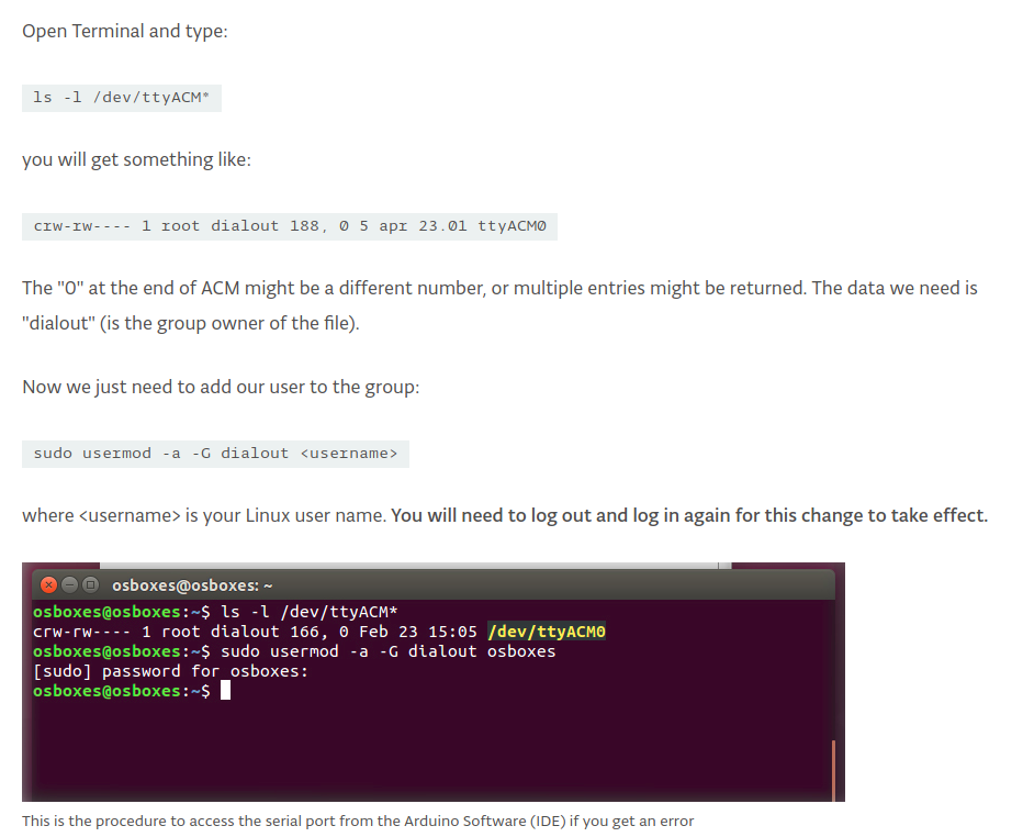

      This is the most common or the most probable error you might have seen if you tried coding Arduino, nodeMCU etc in Arduino-ide.
      It might happen that when you upload a sketch - after you have selected your board and the serial port -, you get an error Error opening serial port ... If you get this error, we google it and the method to debug it is to set serial port permission.
      this is the steps we followed to solve it. Even though the error stilled showed sometimes and had to use this code again.

      An error popped up about the port issue and solution to add the user to the group was mentioned in the terminal and followed the same command. After which the error never showed. I also snap installed arduino.

        7. Open Terminal and type:
          ls -l /dev/ttyACM*
          you will get something like:
          crw-rw---- 1 root dialout 188, 0 5 apr 23.01 ttyACM0
          The "0" at the end of ACM might be a different number, or multiple entries might be returned. The data we need is "dialout" (is the group owner of the file).
          Now we just need to add our user to the group:
          sudo usermod -a -G dialout <username>
        I believes it is a better way to solve your problem. Other way you to try to solve problem is install arduino via:
        sudo apt-get install arduino-core

                @Abhay I think most probably you might have done this earlier while installing Arduino.
