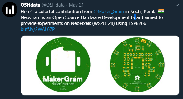

      NeoGram is an ESP8266 based Open Source Hardware Development board aimed to provide experiments on NeoPixels (WS2812B) using ESP8266.
      NeoGram is Powerd by ESP8266-12E Module which is encapsulated Tensilica L106 integrates industry-leading ultra low power 32-bit MCU micro, with the 16-bit short mode, Clock speed support 80 MHz, 160 MHz, supports the RTOS, integrated Wi-Fi MAC/BB/RF/PA/LNA, on-board antenna. The 12 of the WS2812B can be programmed individually as maker wishes to make their project colourful 🌈.

      • 12 x Programmable WS2812B
      • Plug and Play
      • Inbuilt WiFi
      • Inbuilt USB to UART
      • Inbuilt Voltage Regulator
      • Reset button
      • Power led
      • MicroUSB port for programming and debugging
      • The USB port can act like serial port, keyboard, mouse, joystick or MIDI!
      • Powered by ESP8266-12E - 32 bit, running 3.3v at 160 MHz
      • Arduino Compatible
      • Micropython Compatible
      • OpenSource Hardware ❤️
