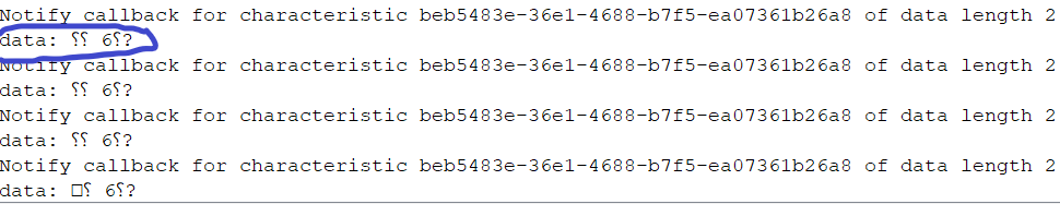

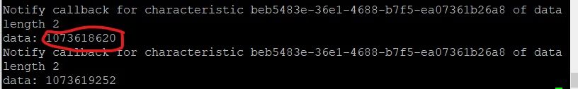

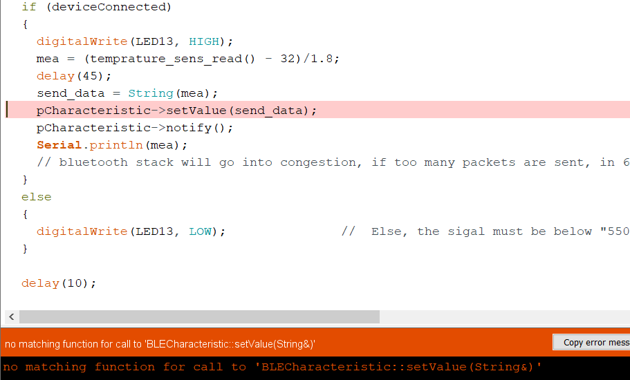

          Hello Salman...Thankyou very much for the reply. I implemented your code and I got below error. doubt.PNG
          I simply tried to read the temperature data from ESP32 and send it to the client ESP32 whenever it is connected. What is my error? Please help me out..!!

              The complete error statement is the same as shown in the above image. Nothing else is printed in the Error Log.

                      @kowshik1729 You are trying to pass a string value (send_Data) to a pointer object(setValue), to solve that you should use std::string class which is an instantiation of the basic_string class template that uses char (i.e., bytes) as its character type.
                      Comment line no.96 which doing convertion from Float value into String using the String constructor
                      // String send_Data = String(mea);
                      and add the following line to use the std:string this will help represent the sequence of characters as an object of the class .
                      std::string send_Data((char*)&mea, 2);
