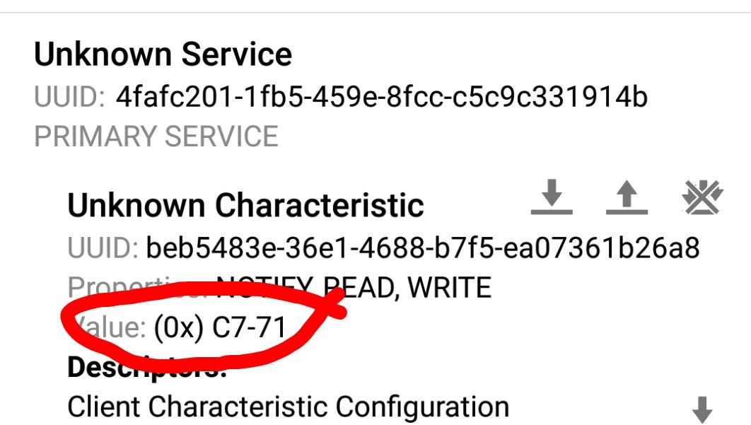

        @salmanfaris Thanks for the reply. I have two concerns with the reply.
        1. I am making an application where the information from the server ESP32 must be sent only to another ESP which means I am not going to read it over phone or anything like that. So, I can't use nRF connect app for my project.
        2. But, anyways I used the app for debugging my project and the information received by me on the phone is something as shown in the below snapshot.
        Please help me out with this sir..!!
          salmanfaris @kowshik1729 last edited by salmanfaris
          @kowshik1729 The nRF app is very helpful for debugging the BLE application like I said the previous replay " The value you are getting as hex,so you should convert the received hex into to string, int or float in order to see the data. " .
