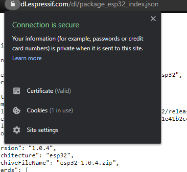

              @kowshik1729 said in Error downloading package:
              The license of the https://dl.espressif.com/dl/package_esp32_index.json might be expired(If this is the reason you can't do anything but just wait until they re-activate the license)
              e210e762-5609-4f60-9409-3c5df1123744-image.png If the page liecence
              It's good.
