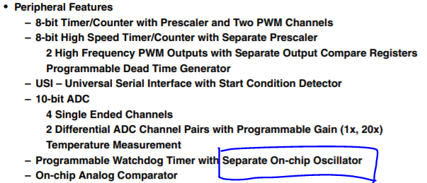

            @Geethesh Hello. First of all greetings from makergram community. I would like to brief you with the architecture aka block diagram that you've mentioned.
            1. The microcontroller which you are trying to use is good for the application. Your choice of component is very appreciable.
            2. Regarding the connection diagram, to answer your question should i want to connect external oscillator circuit my answer is NOO. Because if you look into the datasheet of the Attiny85(same as ATtiny45) you can notice that it has an On-Chip 8MHz oscillator 👇. So, you can breathe now as you don't have to put an external oscillator circuit. Don't worry about the timing issues, they are industry calibrated.

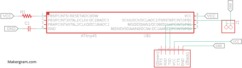

                Hi @Geethesh, If you are building simple POC (Proof of concept ) or Quick prototype then the HC-05 is enough with the ATtiny.
                • For the ATtiny45 minimum circuit you only need one Pull up resistor for Reset, and one Filter capacitor between VCC and ground and you also need to populate ICSP pins for programming
                • You also need only two external componts HC-05 and Buzzer .
                • In the this project we did't require any external oscillator , the internal 8mhz should be fine .
                Geethesh 1 Reply Last reply Reply Quote 2

                  @salmanfaris thank u for the details and circuit
                    @Geethesh , keep in mind ATtiny series doesn't have Hardware Serial, so you should use the SoftwareSerial for that you also need two more for UART communication (Rx, Tx) between Arduino and Bluetooth.
