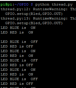

        Yes, you can do Multi Thread in Raspberry Pi using python and note that different threads do not actually execute at the same time: they merely appear to.
        We can easily implement simple threads using threading module. I'll show you some example of how actually it works.
        Example :
        I was trying to blink two LED's at the same time, for that I created a function that does the blink infinitely using while(True) .

        Output :
        Video : https://www.youtube.com/watch?v=AypMEQFpEWo&feature=youtu.be
        since we are using the infinity loop for both methods, the blue() will not stop and red() will not invoke either.
        In these scenarios, we can use multithread both function without waiting for another , let's try.

        t1 = threading.Thread(target=blue)
        t2 = threading.Thread(target=red)
        t1.start()
        t2.start()
        Output :
        Video : https://www.youtube.com/watch?v=HMKYzgdNwd8&feature=youtu.be
        with the help threading module we can simply run both methods at the same time (how we feel).
        I think you got your answer. also, keep in mind to avoid race condition and deadlock while multithreading.

            @salmanfaris Thankyou soo much for awesome example. The video really helped me what it looks like without multi threading. Thank you.
