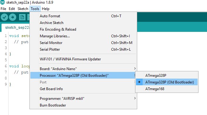

        Hi @Anudeep ,
        There is no compilation error, only problem while uploading to Arduino nano and this error might due to several reasons like a bad USB cable. etc we need to dig more.
        to get more details about this error, can you please enable the verbose. file -> preference -> show verbose output during upload
        and also keep in mind Arduino IDE automatically set NANO board with a fresh bootloader. but boards sold from January 2018 have this new bootloader, while boards manufactured before that date have the old bootloader. so we need to set them manually before uploading
        select the option from Tools -> Processor -> ATmega328p(old bootloader) to flash the old bootloader

          @salmanfaris Yeah, I have checked the cable because I was able to upload to another Arduino Nano. But, I was not able to upload this new Arduino Nano.
          I have tried with both bootloader's new and Old... It's not working with both!!
          So, any help regarding this?
