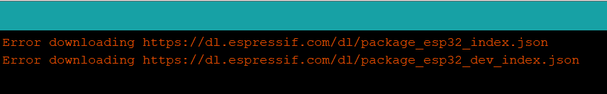

    Arduino boards manager error while installing the ESP32 boards definitions.

      Arduino IDE need internet connection to download tha packages and the error looks like it can't able do that so make sure that you have internet connection on your computer . Also check that you are using Arduino IDE at the 1.8 level or later .
        @salmanfaris

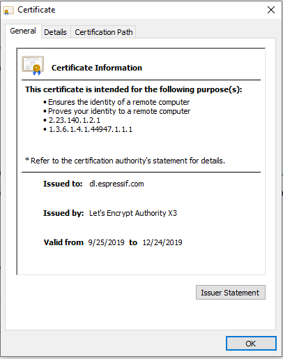

        Thanks for the reply. I am using a stable internet connection and made sure of it. But the issue is not it, according to the internet researches I found that the license certification of the package site https://dl.espressif.com/dl/package_esp32_dev_index.json was expired as of 23rd Septmeber. So, no one will be able to ping the site until it's certification is renewed. I hope it'll be fixed ASAP.
          @kowshik1729, Thanks for the information and you are correct the TLS certificate on dl.espressif.com expired.
          JSON file only for indexing the Different ESP32 boards, so I just move the JSON to my Github repo for an experimental hack, try it and let me know the status
          https://salmanfarisvp.com/ESP/package_esp32_dev_index.json
            Hi @kowshik1729,
            Espressif renewed the certificate today, so try to the official ESP32 Board definition URL to download Board definition.
            URL: https://dl.espressif.com/dl/package_esp32_dev_index.json
            Happy hacking . 👨‍🔧
