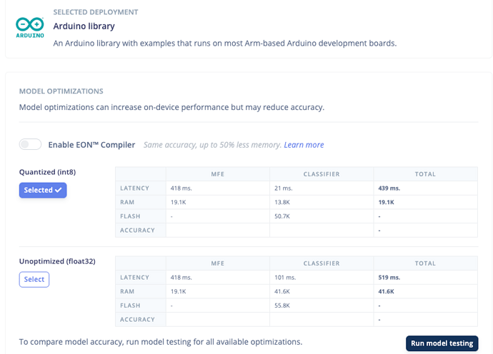

          When I was checking the edgeImpulse memory profiler, it only mentioned 19.1K RAM and I don't have any additional application running along with the inference program. It looks like something is wrong in the compilation.
          I will try to check the memory status as you mentioned and get back, Thanks
