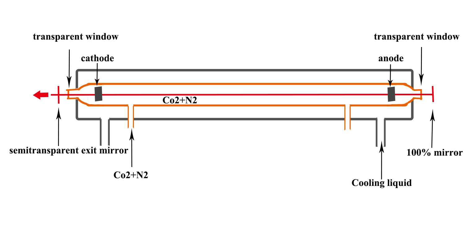

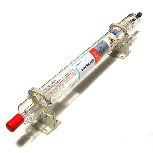

        CO2 (Carbon dioxide) Laser?
        The carbon dioxide laser (CO2 laser) was one of the earliest gas lasers to be developed. It was invented by Kumar Patel of Bell Labs in 1964,[1] and is still one of the most useful. Carbon dioxide lasers are the highest-power continuous wave lasers that are currently available. They are also quite efficient: the ratio of output power to pump power can be as large as 20%. The CO2 laser produces a beam of infrared light with the principal wavelength bands centring on 9.4 and 10.6 micrometres (μm). (Wikipedia)
        CO2 Laser Tube :
        (img src: http://www.xtlaser.kr/co2-laser-work/)

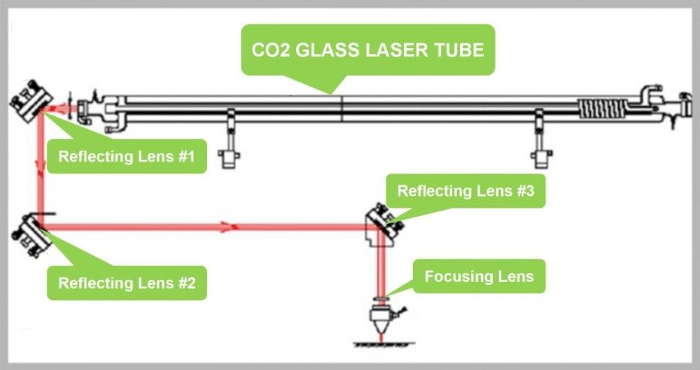

        Laser Beam Alignment
        (img src: https://smokeandmirrors.store//)

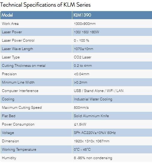

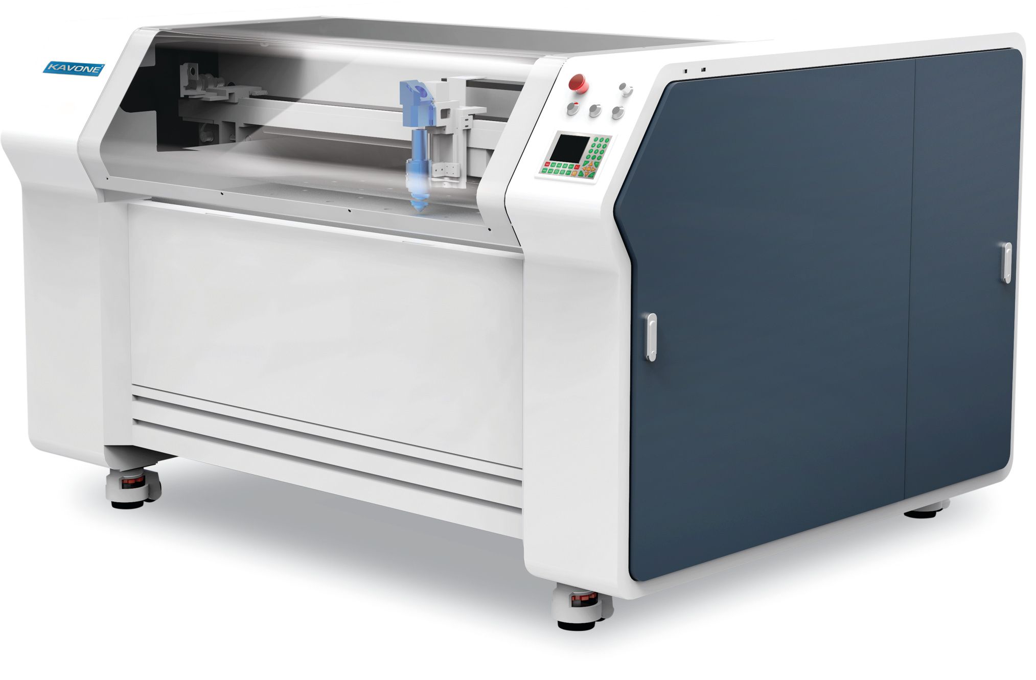

          Kavone KLM Serines 150w CO2 Laser Cutter
          Features
          CO2 metal cutting is the low-cost metal cutting solution. Can be used for metal and non-metal cutting
          Applications
          Cutting on various materials such as Stainless steel, carbon steel, ABS double-coated sheet, Acrylic, Cloth, Leather, Plastic, paper, wood, Rubber, etc.
